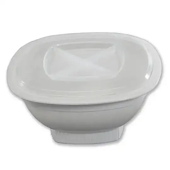

  • @AzorAhai-him- - I have a ceramic "microwave popping" bowl that was designed and sold specifically for this purpose, so yes its A Thing. Its far far cheaper than making bagged microwave popcorn, and you can control the amount made to however much you want (to a max of 1/3 cup increments per batch at least) – T.E.D. Apr 18 '23 at 15:55
