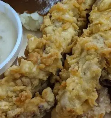

I am trying to get large, flat flakes in my fried chicken.
There are already a couple of stack exchange posts about flaky chicken (here and here), but the flaky coating in these posts is too dense for what I am trying to achieve.
I am trying to get a texture more like these, where the flakes are large and flat rather than stubby and round: enter image description here enter image description here enter image description here
Is there any recipe that can consistently achieve this? I have tried numerous recipes that involve the "wet sand" mixture, but the chicken always comes out stubby. I am also open to store-bought fried chicken mix, if anyone has had experience with a particular brand that achieves this type of flaky coating. Another issue is that my chicken often comes out too dark. What is the recommended frying temperature and oil depth for achieving the light golden color seen in these images?
I was just watching a Youtube video from a favorite chef of mine, and I remembered seeing this question awhile back. He shows a technique that he says is specifically intended to get that kind of texture, specifically, "extra craggies."
To do this:
  • take some of your wet mixture
  • dribble it into the plate with your dry mixture. Important here is that you want loose droplets, not large patches of Wet.
  • mix the droplets into into the dry mix so that you get small pebbles of mostly-dry "dough"
  • now coat your chicken with the "dry" mixture so that the small pebbles of dough coat the surface, creating a craggly surface.
  • batter the chicken and fry as normal.
The recipe for the fried chicken is fairly standard ans should work with the batter of your choice.
