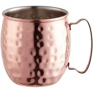

Copper cup?
Note: We have a separate question on whether this is safe, Is copper safe for long-term food storage?.
Bust out your Moscow Mule mug and keep your syrup in that. Mold is exquisitely sensitive to copper. The amount that leaches into the syrup will prevent mold growth, I here assert.

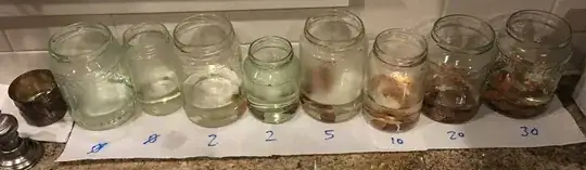

jar setup
Here is the setup as of 11/2 - 1 week ago. I made the sugar syrup with a 1:1 sugar and water mix, heated in a saucepan. Jars were rinsed first. Approximately 150 ml syrup in each of 8 jars. I did not have a copper cup but I had a silver one - also 150 ml.
To simulate a copper metal cup I used pennies. These are American pennies which I washed with dishsoap and rinsed. First 2 jars (0) were controls with only syrup, no pennies. Subsequent jars had 2 pennies (x2 jars), then 5, 10, 20 and 30 pennies.
Experiment is ongoing. Here are results as of this AM 11/9 at 1 week.

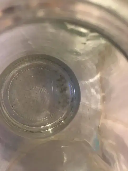

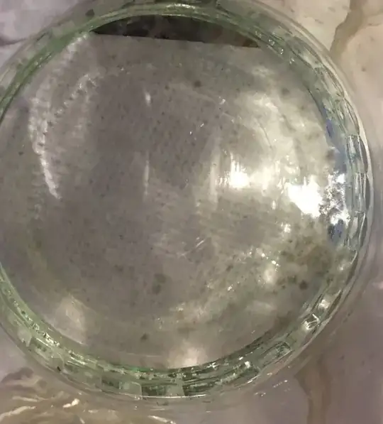

no penny1
nopenny 2
Jars with only syrup and no pennies had mold colonies by day 3 and they are easy to see now. The mold looks like aspergillus (bread mold) and is floating on top.

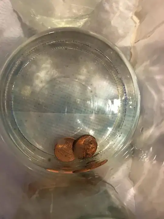

2 pennies
Jars with 2 pennies had a few mold colonies.

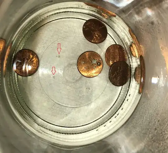

5 pennies
Jar with 5 pennies developed mold for the first time this morning. I put red arrows on the mold colonies.

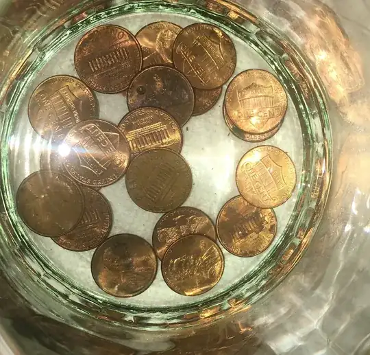

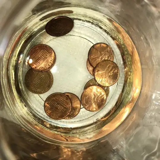

Jars with 10,20 and 30 pennies have no mold colonies yet. Neither does the silver cup. below: 10 and 20 penny cups (30 pennies not shown) and silver cup.
10 pennies
20 pennies
silver cup
For sugar syrup left open at room temperature. addition of metal as copper or silver retarded mold growth over the experimental period of 1 week.

  • Followup at 2 weeks - I threw out the no pennies and 2 pennieis jars because they were so moldy I could smell them. 2 small colonies in 5 pennies jar. No mold in 10,20,30 penny jars or silver cup. I tasted silver cup and 30 pennies; seems fine. – Willk Nov 19 '22 at 14:50

  • It should be noted that American (USA) pennies dated after 1981 are primarily zinc, not copper (97.5% zinc, 2.5% copper) as opposed to pre-1982 which were 95% copper and 5% zinc. So hard to say if the copper from post 1981 pennies submerged in a liquid is a sufficient amount to influence bacterial growth. Would be interesting to see if a solution utilizing a copper supplement (available in drug, health food stores and online), which would be a measurable and safe amount for ingestion, would make any difference. Food grade Potassium Sorbate (also available online) might be a better choice. – Rich Apr 13 '23 at 10:36
