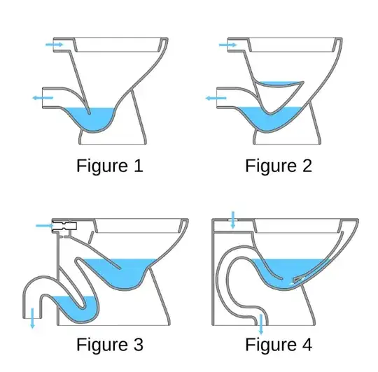

  • The kitchen sink and not flush toilets is the preferred disposal receptacle for both efficiency of water use and ease of addressing clogs.
    Both should have p-bends/air traps to stop sewer gases entering the home, though the kitchen sink will 1) be more easily accessible with the trap normally in a vertical line under the sink drain, 2) the toilet's thermal mass may rapidly cool any added hot water, and 3) some toilets may feature multiple bend traps, leaving undissolved sugar stuck in harder to reach areas. Regardless, both sinks and toilets will clog if enough solid sugar is dumped in as it settles.
    Wiki toilets
    Figures of toilet cross-sections from Wikipedia.
