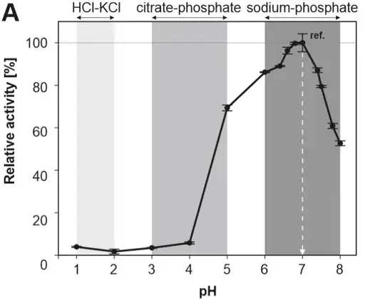

In contrast, the kalamata brine likely has vinegar at <4% formulation, yielding a brine pH roughly between 4-5. This is still a range where alliinase is active, though less optimally.
Alliinase activity and pH ranges
Fig 3. Effect of pH (A) on the alliinase activity at 25°C.[iii] https://doi.org/10.1371/journal.pone.0248878.g003
