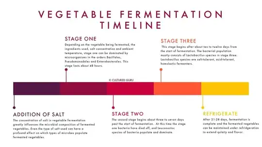

Cultured Guru provides a good detailed overview of the vegetable fermentation process, including the types of bacteria that tend to dominate each phase of the process. Please see the source link for a more detailed overview of each stage.
As for the question of temperature, the fermentation curve will vary between different vegetables and microbial cultures, but anything in the range of 20-30 degrees Celsius does seem to be something of a 'sweet spot' for most types of fermented products. Nourished Kitchen has a fermented beets recipe for 'room temperature', but I suppose that then depends on the typical temperature of your room!
