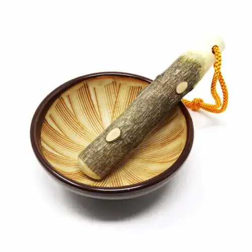

Think About: if what you do is primarily grind spices that come in the form of seeds, think about getting a Japanese-style "combed" texture mortar (see pic). These mortars are specifically designed for grinding seeds, and the rough interior won't grind smooth, particularly if you use the recommended hardwood pestle.
japanese-style combed texture mortar
