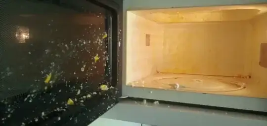

My partner, dissatisfied with raggedy poached eggs, found an alternative method. Most likely on Facebook :P
Break an egg into a glass, add a little water, microwave until cooked.
The first attempt resulted in perfectly shaped, but particularly unsatisfying, part cooked eggs with runny whites.
Today I thought I would have a go, nuking them for a bit longer.
Four eggs, four glasses, a bit of water in each. I opened the door to check after 1:30 and it wasn't quite enough to cook all the white. I added 10 seconds and as I opened the door to check, hilarity struck with a loud pop, including all over me.
An extra breakfast job...
What might have caused an egg to explode?
I have a couple of theories
  1. The white at the top cooked and formed a seal, the rest of the egg expanded below it
  2. The membrane around the yolk was strong enough to hold until the pressure got too much (unlikely I think)

    Thanks @B.Goddard, but if you watch the video from kutykwyfer, that is done and doesn't help. – Steve Aug 15 '21 at 21:09

  • A key piece of information is how you placed the items on the turntable. Did you place things on the center so they spin, or slightly away from the center so they travel in a circle? If the former, then I'd expect heating to be uneven, and a superheated area would be unsurprising. – Don Branson Aug 17 '21 at 19:18
  • @DonBranson items are always placed off centre. Good thought though. – Steve Aug 17 '21 at 21:56
