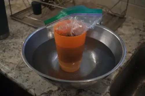

I like iced coffee when the weather is hot, and I like to drink it black (or nearly black) and undiluted. What is a good setup for cooling freshly brewed coffee quickly, without a lot of hassle? I'm talking about normal brewed coffee, not cold brew.
At Starbucks, they seem to put ice in your cup and then pour coffee directly over the ice. This works, but it uses a lot of ice, and by the time you're done drinking it, the melting ice has started to dilute the coffee. You also just can't fit very much coffee in a cup this way, because so much space is taken up by the ice.
I've tried putting a whole bunch of water in a big pan, then sticking a thin-walled metal cup in the water and pouring the coffee into the cup to cool. This cools the coffee rapidly at first, but then the cooling process gets extremely slow. I think part of the problem is that the conduction and convection processes are slow, and also that the water's heat capacity isn't super huge, compared to the heat of melting of ice.
I homebrew beer, and to cool my wort, I have a coil of copper tubing that I insert into the pot and run water through from a garden hose. This is pretty efficient, but works for a quantity orders of magnitude greater than a cup of coffee. It uses a huge amount of water.
Below is a method that I'm currently messing around with. The pan of water is to take the initial heat off of the coffee and make sure the coffee is cool enough so that I don't melt a hole through the plastic parts or release bad chemicals into the coffee from the plastic. I then put some ice in the ziplock bag and stick it in. After a few minutes I can take the cup out of the pan. The ice melts, and then I replace it with fresh ice. This setup seems not too bad, but still kind of slow and wasteful. It uses up a lot of ice. I can wash and reuse the bag.
cooling coffee
Is there a better way to do this? I'm fantasizing about weird gadgets such as an aquarium pump sending pre-chilled vodka or ice water through a closed loop of tubing. Or maybe putting pieces of brass or copper in the freezer.
    @Kat and jmk: Thanks for your suggestions, but I'm asking how to do it rapidly. Doing it slowly, overnight, it easy, but I don't want to have to plan that far in advance. Re the idea of doubling the strength of the brew, I think the main problem with this is that the dilution gradually increases while you're trying to drink your coffee. –  Jul 18 '21 at 17:35

I'm a scientist not a cook, but this is how I would do it.
Conductive cup for the coffee. A thin-walled aluminium is best, but steel works reasonably ok. Glass or porcelain just insulates too well. (consider an empty cola can, that's about as thin-walled as aluminium containers get)
Put it in a container with crushed ice.
Add salt to the ice.
The crushed ice promptly becomes an ice slushy with liquid water at temperatures down to -20C, and with all the thermal benefits of ice's latent heat of fusion (the heat it wants to absorb when melting)
It should cool one cup of boiling water(coffee) down to about 2C in under 30 seconds,
and about 2 minutes later you have a solid block of iced coffee.
At least it does that for a lab specimen that needs to be cooled urgently.

If you want to avoid diluting the coffee at all, put the coffee in a thin-walled metal cup and put the cup in an ice water bath. Make sure there's enough water to conduct the heat rapidly, and enough ice to keep the water bath ice-cold.
Yeah, both of these methods will consume a lot of ice. But you can make ice fast enough to chill all the coffee you want, can't you? If you can't, then the problem isn't the usage of ice; it's the capacity of your freezer.

You seem to have gotten pretty close as you stated in your question
You could easily improve on that by changing a few things:
  • add ice and salt to the water in your big pan. The ice obviously drops the water temperature, but adding salt will make it drop even further through freezing point depression:
    • −20 °C can be achieved with a 1:3 mass ratio of sodium chloride (table salt) to ice.
  • add the coffee to the thin walled metal cup, and stir it. The coffee in contact with the cup walls cool down faster, so stirring moves the warm coffee closer to the cold metal walls.
  • additionally, move the cup around or stir the ice+salt+water (best if not with the same spoon you're stirring your coffee! maybe just move the cup...) to ensure the coldest water is in contact with your cup.
These tips should help you speed up the cooling process without adding much cost.

I use pots and pans to cool hot coffee. You need two of them. Pour the hot coffee into one, put the other under cold water from the tap. Wait a min or two until the pot with the coffee warms up. Then pour out the cold water from the sink pot, and dump the coffee into it. Put the warm pot under the cold tap. Repeat until it's cool, usually takes 3-5 swaps. This gets it to cold-tap temp in minutes, at which point ice doesn't water it down too bad.
You can rinse the last pot and put it back on the rack/cupboard; coffee is water-soluble and so it doesn't need washing. You can also throw in a handful of spoons or forks to increase thermal capacity and heat transfer surface area. I often add all our spoons to the pot while its brewing; they come out hot, which means the coffee is colder before I even start my pan games.

  • I described in the question using this technique and the fact that it didn't work well. –  Jul 21 '21 at 22:55
  • @BenCrowell: part of the reason that it doesn’t work well for you is that you’re using a cup, not a pot, so both the evaporation surface and contact with the cold water are significantly smaller. It also looked like you had a plastic cup…. You want something metal, so it has good thermal conductivity. (Although, using ice water, as mentioned in another answer, would likely be better than changing out the water) – Joe Aug 13 '21 at 12:07

Lots of great ideas and fun things to try on the weekend, but if you want minimal hassle before work try a casserole pan filled with ice and water and an bread pan to pour the coffee in. From your picture, it appears that the coffee is significantly higher than the chilling medium. Using a wider pan means more surface area between the coffee and ice water.
I'll make coffee, pour it into the bread pan and add ice water around it, and by the time I'm ready to make breakfast the coffee is room temp or below. Certainly some dilution there but not enough that I've ever noticed. I have an ice maker so the extra ice isn't really a concern for me - I pour the melted ice and water into my kettle for tomorrow's brew.

  • You can also crush the ice so it’s making better contact with the loaf pan. And you can probably find vessels with an even larger surface area — I have a shallow (about 1” / 3cm) pan that came with my toaster oven. It’s a little longer and significantly wider than a loaf pan, but would still fit with a 9x13 baking dish. You could also use an 8x8 pan, but stick with metal for the inner container— the thermal stress could break glass or ceramics. – Joe Aug 13 '21 at 12:00
