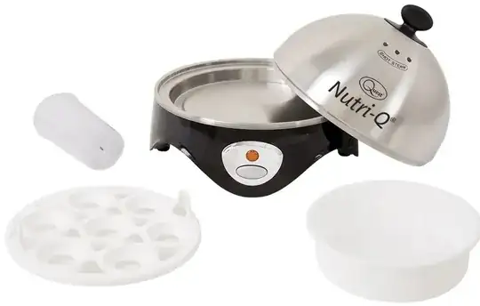

I have purchased a Nutri-Q 34360 Healthy Eating Egg Boiler:
How does it work? - The eggs are cooked through hot steam. The instructions will guide you on the amount of water that is required depending on the quantity of eggs.
It comes with a little measuring cylinder for the amount of water to add which has gradations that look something like:
Hard boiled
- 1
- 2
- 3
- 4
- 5
- 6/7
Medium
  • 6/7
Soft
  • 6/7
I understand why more water is required to hard boil eggs compared to medium cooked eggs (they need to be cooked longer).
However, I don't understand the gradations within each range (the number of eggs to be cooked).
Why does, for example, cooking 1 medium egg require more steam than cooking 3 medium eggs? Surely it should be the other way around?
Can someone enlighten me?

    probably because with one or 2 eggs, there needs to be more steam to fill the space ? – Max Jun 13 '21 at 11:58
  • Maybe, but that doesn't explain 6 and 7 eggs requiring the same amount. – DavidPostill Jun 13 '21 at 12:00
  • Does the boiler stay ON at a constant power for a fixed amount of time irrespective of number of eggs ? If that is the case, more water means, more energy input is spent heating the excess water to 100 deg C instead of heating a little water to hot steam????? – AJN Jun 13 '21 at 13:37
  • @AJN I've no idea how the power is regulated. And I haven't timed how long it is on for. The whole point of buying this is so I don't have to worry about removing my eggs from boiling water at the right time :) – DavidPostill Jun 13 '21 at 13:39
    @AJN there is only an on/off switch. Nothing to indicate number of eggs. And it turns off by itslef. – DavidPostill Jun 13 '21 at 13:41
  • So the boiler has no idea of the number of eggs or softness required. There may be some sensor, but we do not know. Can you post a photo of the cylinder? – AJN Jun 13 '21 at 13:43
  • @AJN There is just a hotplate where you add the water. I don't see any sensors (and I'm not planning to dismantle it). The dome is just a lid that lifts off and which has some holes to release steam. The eggs sit on a removable tray that rests on the hotplate. – DavidPostill Jun 13 '21 at 13:47
  • Near as I can tell, this device dumps a fixed amount of energy (heat) into the chamber. The energy is absorbed by the water and eggs. To cook an egg to the desired doneness requires some (approximately) fixed amount of energy, and heating one mL of water requires some fixed amount of energy. So, roughly speaking, you need water and eggs to, collectively, absorb the correct amount of heat to cook the eggs appropriately. The more eggs you have, the less energy you want the water absorbing, so you need less water. – Xander Henderson Jun 13 '21 at 14:37
  • But this is just a guess, as I can't see how this device actually works. – Xander Henderson Jun 13 '21 at 14:37
  • @XanderHenderson Maybe I should ask on Physics Stack Exchange as I don't either. – DavidPostill Jun 13 '21 at 15:07
  • If you are already in possession of the device, measure the time it stays ON when different number of eggs are boiled. If the time remains same, then the above theory is likely the correct one. – AJN Jun 13 '21 at 15:39

These egg cookers work by simply heating the water until it all evaporates. Most cookers sense when all the water is evaporated, and automatically turn off and/or alerting with a beep or noise. They have a sensor under the hot plate that detects temperature. When water is still in the pan, it keeps the pan cool, and when water evaporates completely the pan bottom will start to get hotter.
The water is heated in the pan in the bottom, works it way past the eggs, and eventually out the holes in the lid.
So why more water for fewer eggs?
The tray that holds the eggs has a bunch of holes in it. Each egg cup has a hole in the bottom so that the steam has direct contact with the bottom of the egg. When the tray is full, it reduces the number of outlets and traps more steam under the tray. Similar to putting a lid on a pot, this reduces the speed of evaporation.
With only one egg blocking one hole, the steam can escape more readily out from the bottom of the tray to the top, and steam will escape out into the room more quickly.
To compensate for the fact that steam is escaping the egg cooker slightly faster when there are fewer eggs, you use slightly more water when there are fewer eggs.
A fun experiment
You could use eggs (or a heat proof substitute... Maybe something ping pong ball or golf ball sized (but not ping pong balls--they melt at 80°C)) to block off the "egg holes" and collect a series of timings for how long it takes for all the water to evaporate as you vary the number of eggs & water.
You should find that when you follow package directions, the timing of the cycle is approximately the same.
Similarly, if you use only one egg, and the "6/7 egg" water amount, you'll find the cycle (and complete water evaporation) faster than the full "1 egg" water amount. Again, this is just because there's an easier path for the steam to escape.
