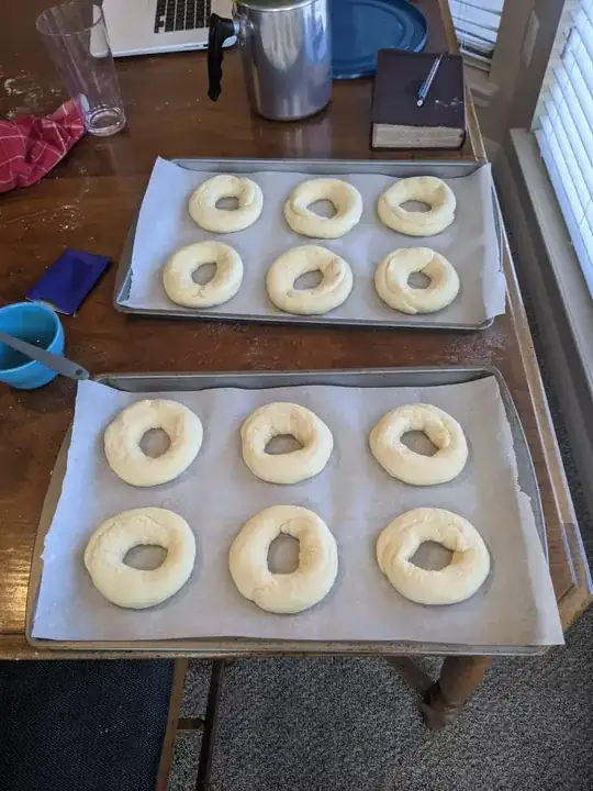

  • form bagels (after I was done forming them all I also went back and stretched out some of the first bagels I'd shaped a bit more)
  • let rest for 20 minutes and then do the float test (mine passed the float test after the 20 minutes)
Here's what the bagels looked like at that point: enter image description here

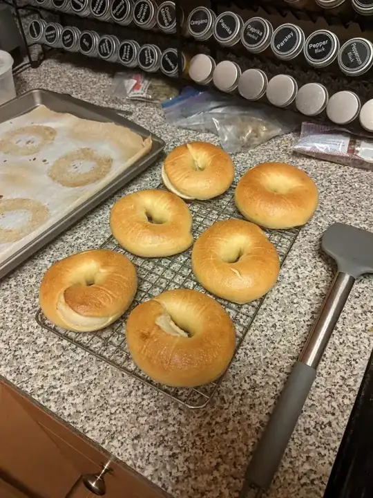

  • take out of the fridge and boil as soon as they pass the float test (mine did right away), 1 minute on each side. This is where things started going wrong. Mine puffed up nicely in the water, but then they started to deflate as soon as I took them out.
  • bake. I saw my somewhat deflated boiled bagels and thought "they'll spring up in the oven!" but alas...basically no oven spring. You can see the result above.

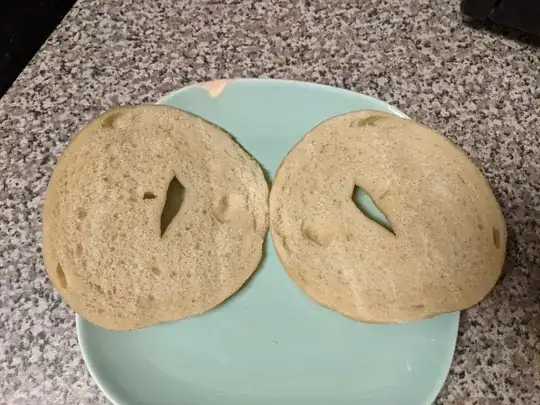

The finished bagels are tasty and chewy, and the crumb is somewhat dense but not THAT bad:
But they're so flat!! The uncooked formed bagels almost look taller, like they spread out during/after boiling instead of poofing UP.

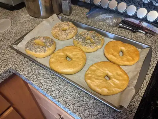

Per Johanna's diagnosis of overproofing, I tried halving the yeast and then otherwise making the bagels as I did above (just with a bit of extra rise time for the sponge), and they turned out so much better!!
happy bagels
I pulled out a couple after 4 hours in the fridge, and they puffed up well but were not particularly flavorful. The rest I took out and boiled after 24 hours, and those were great!
