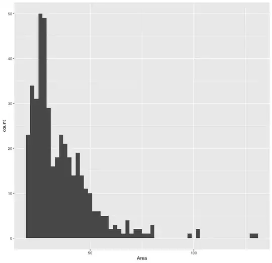

The sum of areas is 15558 pixels and the distribution looks like this: size of particles:
This tells us that there are a couple of outliers in the data, that are probably skewing the mean area a bit (and also that the watershedding didn't work fully). The data doesn't look quite like I would expect - I was expecting more of a bell-shaped curve, less heavily skewed to the left, but I did cut off data less than 20 pixels, so the left-side of the curve is a bit selection-biased anyway.
