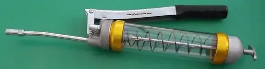

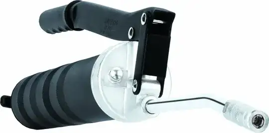

Consider using a "grease gun" as used by mechanics.
These are used to pump high viscosity grease through small orifices.
The pressure can easily be as high as required. These are available new in the US$10-20 range and possibly even cheaper. (You can also pay far more, but there's no need to).
Grease guns come in many many many shapes and sizes, as can bee seen in these images.
Some GGs use a disposable cartridge, but some can be packed with grease, or other stuff, as required. A plunger allows the total contents to occupy only a small part of the tube. Even one intenmded for use with a cartridge could have a tube of the right diameter used inside as a cleanable refillable cartridge.

    @Sneftel No. A typical grease gun, and especially a cartridgeless one, has a loading hole diameter many times larger than that of a typical funnel. Maybe typically around 1.5 inches diameter (without going and looking)). Thick pastes could be delivered into the opening with a desert spoon or spatula and pressed down to allow more to be loaded. – Russell McMahon Feb 11 '20 at 09:56
    @Luciano If the GG was new then use with food would be no problem. If you want to be REALLY sure then GG's like this one are made for use with food grade grease - so using food as grease should be fine :-) – Russell McMahon Feb 11 '20 at 10:04
  • I've got that first grease gun. The hole is under a millimetre, and a thick sauce would simply not move through very fast if at all. It'd be a pig to clean as well, and anyone with garage-skills will wonder why the grease gun is on the dinner table. – Criggie Feb 11 '20 at 10:04

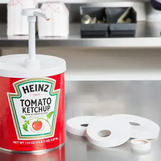

On the other hand, you can get a condiment hand pump, instead. This would be on the order of those large, 1 gallon ketchup, mustard, and mayo containers that are available at grocery stores.
{Random pic from the internet.}
Condiment pump
