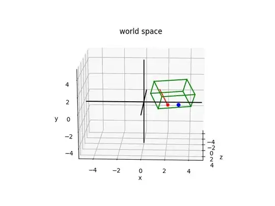

The red line connects the two points on the near and far plane. The red dot is the point on the near plane, which is your "screen" in a 3d space. The green lines mark the borders of the frustum. In clip space, it is obviously just a cube. An important thing to realize is, that clip space is defined in a left-handed coordinate system while the other coordinate systems are usually right-handed (have a look at the images in this link). I mention it since I had some problems with the plots until I realized that.
Now for perspective projection, I get the following plots:
view space perspective world space perspective
The blue dot is the camera position. If I just exchange the perspective matrix with an orthographic projection matrix, the results look like this:
view space orthographic world space orthographic
As you can see, the approach you used in your first code section works independently of the chosen projection. I don't know why you thought it wouldn't. An assumption of mine is, that you might have made a small mistake during the implementation of the orthographic projection matrix. For example, if you accidentally flipped rows and columns (transposed) of the orthographic projection matrix, you get total crap like this:
transposed orthographic projection
I know this looks like a wrong implementation of the perspective projection, but this is what I get when I transpose the orthographic projection matrix before the multiplication.

plt.figure() ax_world = plt.gca(projection="3d") render_ray(mouse_pos_near_world, mouse_pos_far_world, ax_world) render_frustum(points=points_world, camera_pos=camera_position, ax=ax_world) ax_world.set_title("world space")
