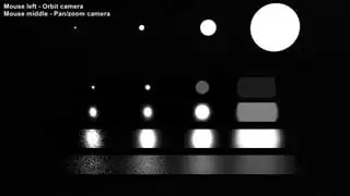

I'm trying to implement multiple importance sampling, as described in the PBRT book (no bouncing yet, I want to make MIS work first).
What my problem is, that while the BRDF sampling looks okay, the light sampling is much dimmer (yet according to the pictures in the book they should look the same in intensity).
sampling the BRDF sampling the light
I uploaded the (updated) compilable code (VS 2015). The relevant parts can be found in multipleimportance.frag (SampleLightsExplicit) and pbr_common.head (ConeSampleSphere).
(note that I don't apply the MIS weights yet)

My question is why light sampling looks so dim? Did I misunderstand something?

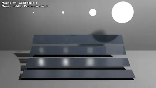

So regarding intensity the second picture is the "correct" one. The dimness is still a problem tho. Changing the Fresnel F0 to 0.11 (as it supposedly is in the book) and applying the MIS weights, the picture looks a lot more promising, except for the topmost plate which should almost explicitly reflect the light sources:
So this is almost okay now. I'm gonna look deeper into the MIS part to see why it makes those highlights disappear.

Shoot me... After the fixes I posted above, I started debugging Mitsuba to see whether it does anything differently on a large scale. Of course it didn't; my code is completely correct, the dimness is due to this macro def:
#define EPSILON   1e-5
This is used in divisions to avoid dividing with zero. Unfortunately, it accumulates to a large value during the calculations. Changing it to 1e-9 fixes everything:
mis_final
For future generations I leave the source code up (just remember to change this value).
