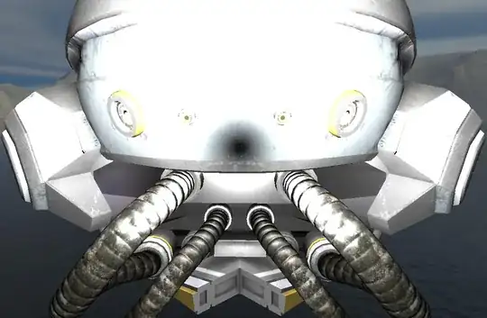

It's probably something obvious but there seems to be a strange issue with lighting in my pipeline. I'm trying to keep everything in world space at the moment for simplicity but cannot figure out what's going on here. Take a look at my code:

This is before IBL is applied but I don't think that will make a difference here. Anyways, here's the weird result I'm getting (keep in mind the camera is the same as the point light position):
camerapointlight
For reference I'm using this model https://github.com/KhronosGroup/glTF-Sample-Models/tree/master/2.0/DamagedHelmet . Thanks to anyone who can help
    Do you know if this is coming from the specular or diffuse contribution. I would start by making your shader output one contribution at a time so you can narrow down the source of the problem. – PaulHK Jul 08 '19 at 07:57
  • I'm not sure I understand how the textures are being read, it looks like you read normals from a texture in the geometry shader, and then use another texture (whose origin I don't understand) in the pixel shader. Can I see your varying and attribute declarations too, as well as the code which sets up the textures so I can see their format ? – PaulHK Jul 08 '19 at 08:03
  • @PaulHK No problem, I've updated the above code. Since this is deferred rendering, everything is flowing from top to bottom. The geometry pass outputs to multiple render targets in an off screen framebuffer then switching to the on screen framebuffer to combine all the gBuffers then render onto a single quad. Btw the geometry pass fragment shader is reading a normalmap (aka bump map) in tangent space then transformed to world space to be sent through a gBuffer to the lighting pass. – user1117065 Jul 08 '19 at 16:47
  • Also, it seems to be coming from the diffuse component. – user1117065 Jul 08 '19 at 16:56
Turns out it had to do with the V vector working differently in deferred rendering than it does in forward rendering, something that I overlooked and seems obvious now. Specifically, I passed the view direction calculated in the camera class to the lighting pass fragment shader then negated it like so vec3 V = normalize(-(cameraPosition - v_pos));. Things seems to be working well now!
