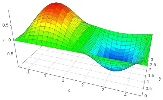

Now, consider the gradient of a scalar field, $\operatorname{grad} q$. (For instance, $q(x,y) = \sin x \cos y$.) The potential can be drawn as a height field: plot of z = sin(x)*cos(y) Then the gradient of this field puts at each point a vector pointing in the steepest uphill direction: vector field grad(sin(x) * cos(y)) But since you're always going "uphill" as quickly as you can, I think it's clear that there's no circulation in this vector field! In fact, for any scalar potential $q$, $$ \operatorname{curl}\operatorname{grad}q = 0 ! $$
