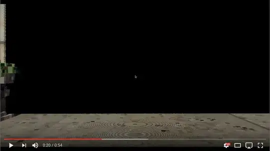

Currently I noticed a circular pattern aliasing and I am not sure what could be causing it.
This video shows the aliasing (sorry for the awkward camera movement my controls are not good right now). The magenta cube is the light's position.
https://www.youtube.com/watch?v=rtFDTQoKX_A&feature=youtu.be
Here's a still from the video:
Moire Patterns

  • This looks a bit like the typical self-intersection issues you sometimes get with ray tracers, were the intersection point of a ray is sometimes slightly inside the object you are testing (rounding error), so resuming from that point can result in a instant hit on the same object. I'm guessing those rings are shadows ? – PaulHK Jul 18 '18 at 09:29

    If you change your shadow colour to say red, does the ringed artefacts also turn red ? Just watched your video again and it seems the artefact gets stronger the further away from the centre of the mesh the camera goes. What is the dimensions of your scene ? – PaulHK Jul 20 '18 at 02:38
