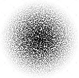

I could make it by Worley noise
Worley noise is a noise function introduced by Steven Worley in 1996. In computer graphics it is used to create procedural textures,that is textures that are created automatically in arbitrary precision and don't have to be drawn by hand. Worley noise comes close to simulating textures of stone, water, or cell noise.
https://thebookofshaders.com/12/

you can see this In shadertoy https://www.shadertoy.com/view/XlSBDz
GL_POINTSon screen quad. These would have variable size of point as function of distance from screen center and would be textured as circle. Their screen position would be precomputed using Hammersley Point Set – mdkdy Jan 05 '18 at 20:22
