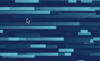

Bad
Here I'm dragging canvas up and down with mouse cursor. See how particles leave a trace?
