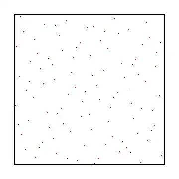

The problem is this: If you use white noise random numbers to do your sampling, you may get samples clumping together like the image below. Given enough samples, it will converge, but it will take a while before it gives good coverage over the sampling space. Find a region of empty space in the image below (like in the lower right) and imagine that there was a small, bright light there and that the scene was dark everywhere else. You can see how not having any samples there is going to make a problem for rendering.
Alternately, you could sample at even intervals like the below, but that will give you aliasing artifacts instead of noise, which is worse.
One idea is to use low discrepancy sequences and do quasi monte carlo integration (https://en.wikipedia.org/wiki/Quasi-Monte_Carlo_method). Low discrepancy sequences are related to blue noise, which has only high frequency components. Going these routes, you get faster convergence of $O(1/N)$ instead of $O(\sqrt{N})$. These give better coverage of the sample space, but since there is some randomness (or random like qualities) to them, they don't have the aliasing issues that regularly spaced sampling does.
Here is a "jittered grid" where you sample on a grid, but use small random offsets within a cell size. This was invented by pixar and was under patent for a while but is no longer: enter image description here
Here is a common low discrepancy sequence called the Halton sequence (basically a 2d version of Van Der Corpus)
And here is a poisson disc sampling, using Mitchel's best candidate algorithm:enter image description here
More information, including the source code that generated these images can be found here: https://blog.demofox.org/2017/05/29/when-random-numbers-are-too-random-low-discrepancy-sequences/
