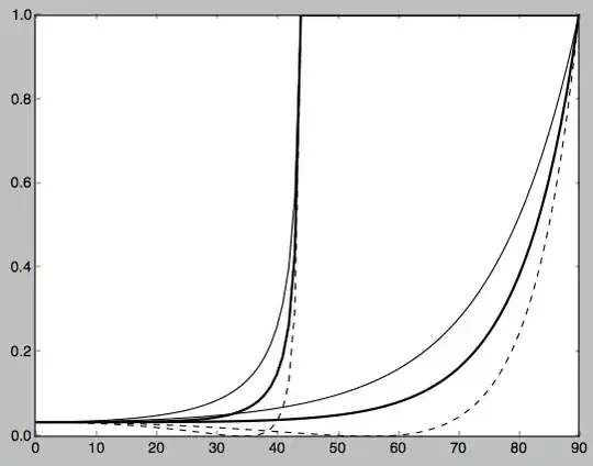

@PaulHK's answer is correct I'm sure, here's a bit of a check to show that the IOR() function is calculating the reflection coefficients for $s$ and $p$ polarizations then averaging the two assuming unpolarized incident light.
The reflection is for a single interface, and at least at normal incidence the results reduce to the simpler $(n_2-n_1)^2/(n_2+n_1)^2$. With this script you can check against other on-line calculators using non-zero incident angle and nonzero values for $k$.
I cleaned up the python a bit (indents) and added the plot. You can see when exiting from glass to air, the reflectivity goes to 100% at the critical angle for total internal reflection:

import math
import matplotlib.pyplot as plt
n1, n2  = 1.00, 1.45  # into glass, one side only
n2ovrn1 = n2/n1
Rin, Fsin, Fpin = zip(*IOR(n2ovrn1, 0))
print Rin[0]
print (n2ovrn1-1.0)**2 / (n2ovrn1+1.0)**2  # check
n1, n2  = 1.45, 1.00  # outof glass, one side only
n2ovrn1 = n2/n1
Rout, Fsout, Fpout = zip(*IOR(n2ovrn1, 0))
print Rout[0]
plt.figure()
plt.plot(range(91), Rin, '-k', linewidth=2)
plt.plot(range(91), Rout, '-k', linewidth=2)
plt.plot(range(91), Fsin, '-k')
plt.plot(range(91), Fsout, '-k')
plt.plot(range(91), Fpin, '--k')
plt.plot(range(91), Fpout, '--k')
plt.show()
