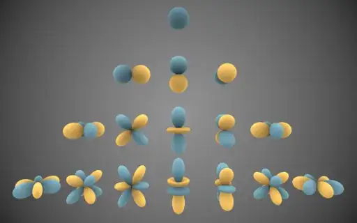

And when you visualize them they become...

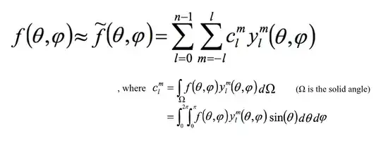

So while I were looking at Spherical Harmonic Lighting | Simon's Tech Blog
I found this equation... enter image description here
So now I know that the mysterious yellow part of the equation was "solid angle related". I do know how to do solid angle but I still don't understand how to do it.

  • After reading your answer I edited my question to ask you with some description. I don't understand why you don't do the green part of the equation. Are you already doing it but then I am not being able to see what you are doing? Or is it that there are more than one way to make SH map? – Blue Bug Apr 18 '17 at 00:59

  • You don't need to do linear regression. Since SH form an orthonormal basis, each SH's coefficient will be equal to the inner product of the cubemap with the SH: the spherical integral of (cubemap * SH). Or in other words, sum (pixel color * SH evaluated at that pixel's direction vector * solid angle of the pixel) over all pixels in the cubemap. – Nathan Reed Apr 15 '17 at 05:45
