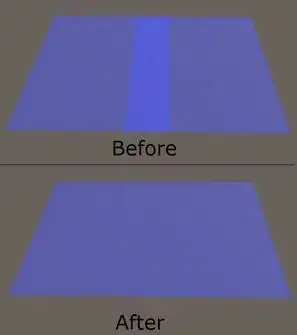

I used Stencil Buffer to fixing your problem , you need a way for checking overlapping two or more shapes
 Shader "Custom/SemiTransparent"
    Properties
        _Color("Color",Color) = (0,0,1,0.1)
    SubShader
Tags {"Queue"="Transparent" "IgnoreProjector"="true" "RenderType"="Transparent"}
ZWrite Off Blend SrcAlpha OneMinusSrcAlpha Cull Off
        LOD 100
        Pass
            Stencil {
                Ref 0
                Comp Equal
                Pass IncrSat
                Fail IncrSat
            CGPROGRAM
            #pragma vertex vert
            #pragma fragment frag
            #include "UnityCG.cginc"
            fixed4 _Color;
            struct appdata
                float4 vertex : POSITION;
            struct v2f
                float4 vertex : SV_POSITION;
            v2f vert (appdata v)
                v2f o;
                o.vertex = UnityObjectToClipPos(v.vertex);
                return o;
            fixed4 frag (v2f i) : SV_Target
                fixed4 col = _Color;
                return col;
            ENDCG
