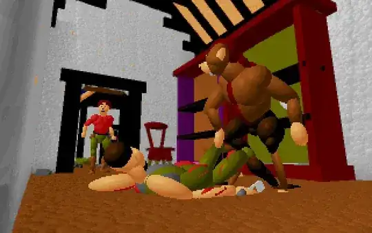

    You may be interested to read about the ellipsoid rendering of the Ecstatica series back in the 1990s.
    Ecstatica screenshot
    – IneQuation Jan 03 '17 at 09:28
