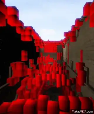

And it works:

The result:
As you see in the binary version it flickers and I have failed to find out the logic behind this (yet). However, voxel positions seem to be fine. I can render these voxels also by raymarching through the texture and this flickers too.
