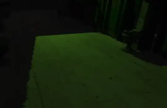

But unfortunately it doesnt work as expected:
Is there a way to make it work (in ESM way, not traditional due to acne) or due to sampler2DShadow specification it is rather impossible? In traditional way it is possible.

PCF does N shadow tests, where each test returns 1 (in light) or 0 (in shadow), and returns the average of the results. sampler2DShadow is a special sampler where PCF is applied to the nearest texels to a sample, based on the depth coordinate provided. So you can't use it with ESM.
