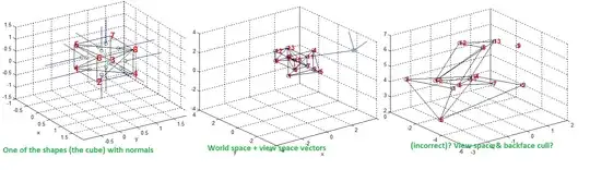

I'm attempting to model a simple graphics pipeline - using Matlab at the moment as a modelling tool to get the transformations correct. I appreciate there are software tools that would make this easier - but I'm looking to understand the maths behind it and hence am looking to mostly use simple functions & matrices that I'm learning from a book (very retro!).
I've successfully got through the stages of defining simple objects and converting them into a universal world space - but have come unstuck with the mathematics required to convert an object into view space and the back face culling.
I believe my view space transformation is correct because when I plot the composite vectors they appear correct - but - when I do the back-face culling, it seems to fail to remove the correct triangles. Given that it depends only on two things, the line-of-sight vector and face normals, I can't work out what I'm doing wrong.
When defining the triangles in local definition space, I did it so that all the normals pointed outwards. I've put my results into the image below
My questions are:
  • Have I gone wrong, or are my expectations incorrect?
  • If so where, and how do I fix?
Progress
I've plotted the normal's of all the shapes when in view space. They have all been inverted and now point inwards. Is this a property of the transformation and could it be responsible - or should this have no effect because all the polygons are affected the same?
(Have changed the code to show this)

davidhood2
  • 243
I (believe) I've solved this (even if it has taken 2 days). My problem was essentially I wanted to take the dot product of the face normal, and line-of-sight vector like below
And determine the angle to see if the face was looking towards or away from the view point.
My erroneous step was that I was doing this AFTER transforming from world-space to view-space - hence the line-of-sight vector I was using was no longer valid.
Hence, to solve this, I simply performed the back-face culling in world-space, prior to the world-view space transformation!
I've included functioning code showing the back face culling, but not the view-space transform.
