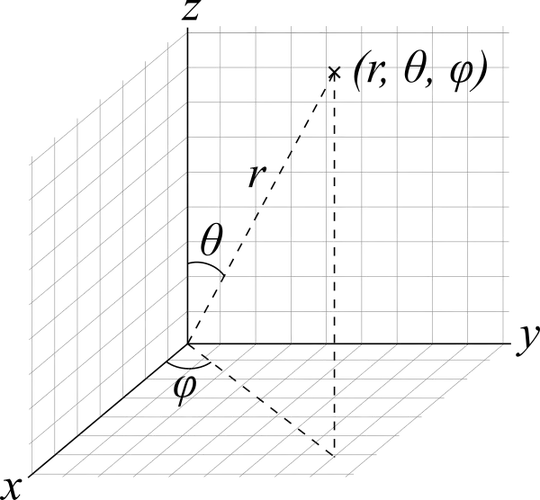

The ASTM file is a flattened version of the MATLab data file, with one major difference: the input and output vectors are in spherical coordinates, specifically the traditional physics notation:
The data is defined in the following range:
For input vector, $\theta$ (theta) varies from $0$ to $\frac{\pi}{2}$, and $\phi$ (phi) is always a constant $0$.
The output vectors are uniformally distributed across the hemisphere. Since $\phi$ is periodic on $2\pi$, mathematically you can define the bounds of $\phi$ in an infinite number of ways. In this data set they chose: $$\phi = [-\pi, \pi]$$ but it would be perfectly fine to choose $$\phi = [0, 2\pi]$$
