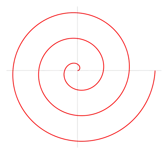

Im trying to plot the x and y positions of an Archimedean spiral in C++.
Archimedean spiral

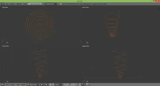

This isn't really a direct answer to this question (that already has an answer anyway), but might interest people who want to implement this algorithm in 3D.
I had to try implementing this algorithm to generate 3D spirals in blender using Python (could easily be converted to drawing with PIL or Matplotlib in 2D). So here's the algorithm and result:
import bpy
from math import cos, sin
S = bpy.context.scene
def add_archimedian_spiral( size = 0.1, length = 500, height = 1, name = 'archispiral' ):
    mesh = bpy.data.meshes.new( name = name )
    o = bpy.data.objects.new(name, mesh)
    o.location = (0,0,0) # place at object origin
    S.objects.link( o )
    z     = 0
    verts = []
    for i in range( length ):
        angle = 0.1 * i
        x     = ( 2 * size * angle ) * cos( angle )
        y     = ( 2 * size * angle ) * sin( angle )
        z    += i / 10000 * height
        verts.append((x,y,z))
    edges = []
    for i in range( len( verts ) ):
        if i == len( verts ) - 1: break
        edges.append((i, i+1))
    mesh.from_pydata( verts, edges, [] )
add_archimedian_spiral( size = 0.2, length = 500, height = 6 )
