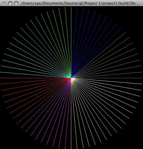

What am i doing wrong?... I know that the bresenham algorithm might have to be modified to overcome slopes greater 1 and lower that 0.
Clarifying the problem
I am trying the iterate the 2d array in a circular manner, using bresenham line algorithm .

I want to output the values the beam hits on the matrix, at each angle.. Which i don't get.. I want to sample the points which the beam intersect in the matrix..
Bob Burt
  • 183
  • Scrolling through your output quickly, it looks reasonable. Although it's hard to tell since it's not plotted as an image. Can you clarify what the problem is? – Nathan Reed Dec 08 '15 at 19:02
  • Hope the addition make it more clear.. – Bob Burt Dec 09 '15 at 16:44
  • Hmmm...it's still not very clear to me. Is the problem that e.g. at a 45 degree angle, the line only goes out to (7, 7) and stops, instead of going all the way out to the corner at e.g. (10, 10)? – Nathan Reed Dec 09 '15 at 18:07
  • yes exactly.. but also that the method only works for slopes within 0-1 – Bob Burt Dec 09 '15 at 18:11
The endpoint of the line doesn't extend out to the edge of the box because you're using the circle equation with a fixed radius:
double x2 = x1 + (lenght * cos(radians));
double y2 = y1 + (lenght * sin(radians));
This makes the endpoint trace out a circle as the angle is changed.
If you want the endpoint to be on the edge of the box, one way is to set up a ray from the center of the box at the desired angle, then calculate the intersection point of the ray with the box. This article shows how to calculate ray/box intersections.
Another way is to loop over the points around the sides of the box, rather than looping over angles. You would have four separate loops, one for each side, and holding one of x or y fixed while iterating the other. For example, holding x = 10 and iterating y from -10 to +10 would go up the right side.
As for the slopes outside [0, 1], you must extend your Bresenham algorithm for it. This can be found in any tutorial or sample of Bresenham, for example the implementations here.
