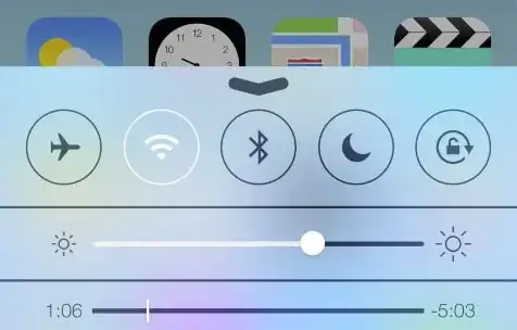

I think you may want to take another look at the iOS user interface if you consider real-time blurs to be out of range of mobile hardware:
iOS control center iOS notification center
Blurs are totally in range of mobile hardware. Yes, you need a fairly large number of texture samples for a blur with a large kernel, but the texture samples are also cached very well, and you can use a separable blur, which effectively means that an MxN blur requires M + N samples, not M * N samples. You can also take advantage of hardware bilinear sampling to reduce the number of samples that your blur requires.
John Calsbeek
  • 3,972
    I know about the Notification Center and Control Center. But I doubt that these blurs are calculated in real time as the active app is frozen while one of them is shown (or at least it does not update the UI anymore). But the links look promising. Thanks! – Nero Aug 11 '15 at 06:40
    @Nero I suspect that's mostly for power reasons. When you swipe down from the Springboard to get to Spotlight, you get a variable-width blur depending on how far you've pulled down, and that's certainly real-time. – John Calsbeek Aug 11 '15 at 14:30
