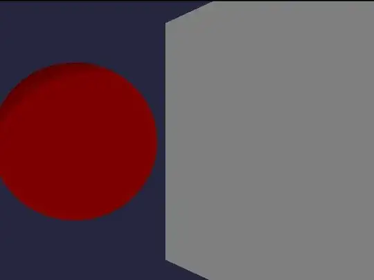

Here's a picture of my most recent output, I'm trying to get a shadow in the bottom left corner of the light gray plane.
The shadow should be in the lower left corner of the plane

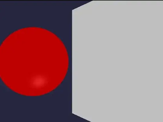

edit: New image: New image!

  • Thank you very much for your help, I really appreciate you taking the time to write it. I have implemented your suggestions. Unfortunately, my shadows are still missing. My most recent output is in the original qustion. I'm assuming this means the problem is somewhere upstream in my code. Of course, that's about 200-300 lines of setting my stage. If you've got the stomach for it, I've put it on pastebin. If you don't, I totally understand. I really appreciate your assistance; I've been so close to this for so long I think I've become blind to my mistakes – user1764241 Nov 19 '15 at 23:55
    If you're still having trouble, just apply the usual debugging techniques. Keep simplifying your code to cut the problem space in half. Try removing all the shading computation and just set the colour to intersections / 999999, so your unshadowed intersections are just white. Draw an object at the light position to make sure it's correct: in both your renders, it looks like it might be in the bottom-right of the image, between the two objects. Put a breakpoint conditional on the shading co-ordinates and step through the shading of one particular point that you know ought to be in shadow. – Dan Hulme Nov 20 '15 at 09:19
