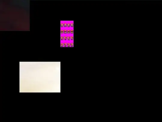

My problem is the following:
middle one is way too stretched, whereas bottom one's UV are incorrect, since they aren't filling the whole quad
As you can see, the middle and bottom images aren't rendering correctly (middle one is way too stretched, whereas bottom one's UV are incorrect, since they aren't filling the whole quad), however, I'm 98% sure both my vertex and instance data are correct, since when I was using the previously mentioned uniforms, they were rendering correctly.

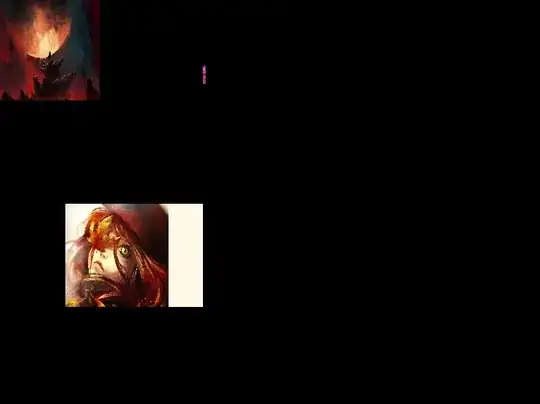

Also, I might 've spotted the problem: the indices. Somehow, if I change my glDrawElementsInstanced's count value to say, 12 indices, the middle one renders correctly, whereas the other 2, do not (see picture below). Same thing happens if I change them to 18 (the last one renders correctly and the other 2, do not).
What might the problem be?

  • Sorry for double posting, however, strangely enough, this is what happens when I turn on the "wireframe mode". The middle quad gets cut. – Darkilon Oct 29 '15 at 05:01
