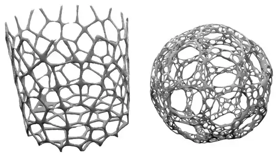

I would like to implement a Maya plugin (this question is independent from Maya) to create 3D Voronoi patterns, Something like

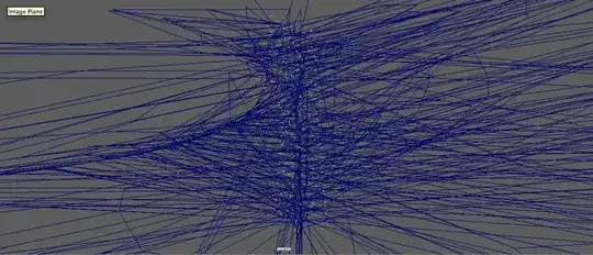

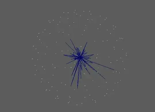

[EDIT] Here are a few example of what I get handling the result i get from scipy.spatial.Voronoi like this (as suggested here):
vor = Voronoi(points)
for vpair in vor.ridge_vertices:
    for i in range(len(vpair) - 1):
        if all(x >= 0 for x in vpair):
            v0 = vor.vertices[vpair[i]]
            v1 = vor.vertices[vpair[i+1]]
            create_line(v0.tolist(), v1.tolist())
The grey vertices are the sampled points (the original shape was a simple sphere): enter image description here
Here is a more complex shape (an arm) enter image description here

  • The images you show have done the voronoi on the 2d function. – joojaa Oct 22 '15 at 03:57
  • @joojaa From the example images I expected that the Voronoi cell edges on the 2D surface were what was required (to give a collection of line segments connecting points on the sphere surface, rather than the collection of plane sections that would be given in 3D). However, scipy.spatial.Voronoi seems to be designed for N dimensional spaces rather than surfaces embedded in them. I can't immediately see how it would be used for 3D points constrained to a 2D surface. – trichoplax is on Codidact now Oct 22 '15 at 10:07
  • Is not a problem to me if I have to change library or to write my own implementation. If you can suggest any source I need to look at I will be happy to do it! – Jiloc Oct 22 '15 at 10:20
  • I'm guessing you would need to implement a distance function for two points on a surface. On the sphere you can get away with just using the 3D Euclidean distance but for arbitrary shapes you'll need something more specific otherwise points that are near to each other in 3D due to folds in the surface will appear nearer to each other than to points between them. – trichoplax is on Codidact now Oct 22 '15 at 14:29
  • Do you mean to sample points? I am using isotopic distance to accomplish this. Anyway as you see, my problem is with the Voronoi computation, not the initial sampling procedure, but maybe I didn't understand what you were saying! – Jiloc Oct 22 '15 at 14:36
  • No I meant the Voronoi step - converting cell centres (the Poisson sampled points) into cell edges. This also requires a length calculation in order to determine which line is equidistant from a given two points. – trichoplax is on Codidact now Oct 22 '15 at 20:37
