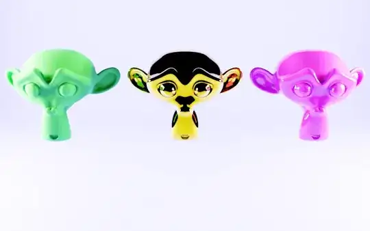

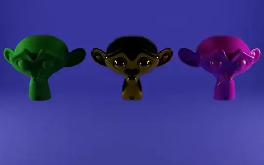

Here are some examples: for reference, this is a test scene I'm using, rendered with Cycles, containing two emissive squares each of emission respectively 2, 10, 100 and 1000 emission 2 emission 10 emission 100 emission 1000
Here is the same scene, with the same factors, rendered with my renderer, applying this tonemapping function directly to each color channel, after exposure-correcting (histogram-based, clamped at 50% for dark and 5% for light) 2 10 100 1000
Here are the tests without exposure correction (same tonemapping): 2 10 100 1000
Here, I am using the answer's method to deal with the alternative "scaling" (with the same tonemapping function I used for the results above).
2 10 100 1000
The exposure-corrected gives clearly wrong results, as the 10, 100 and 1000 values all give pretty much the same output, the non-exposure-corrected one has some weird saturation values but it's perceptively the closest to Cycles' illumination levels; the answer's method flattens the background too much, and feels a bit darker than it should, at least compared to Cycles' output.
