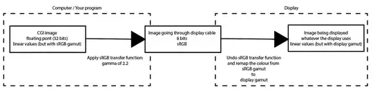

To try and make things a bit more clear, here's an example showing how a transfer function works when displaying an image that is either CGI or a video game being rendered. The first thing that is important is that both the computer/program and the display need to agree on the colour space to use. In this example, we use sRGB. Basically, the program sends the sRGB image to the display and the display takes that sRGB image and converts it to the actual electronic signals to send to the pixels. Image being sent to display

  • The display will undo that transfer function (and will do it no matter what, so you have to apply the transfer function on your end to get the correct values when displayed).
