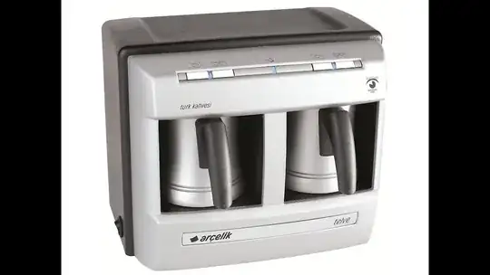

As far as I understood, such coffee is ground for Turkish. If this is the case, you may try to prepare your coffee in a pot. If you are really considering (somewhat) automated machine, you may go for Turkish coffee machines. Keep in mind, that they don't prepare coffee as good as an experienced human; but they are nice enough to drink. I put an image of one of those, so you can search it on the web.
Arçelik Telve, Turkish coffee machine

  • I didnt know there was a turkish coffee machine, i hadnt even considered that. But what if I dont want to drink the grounds? – j0h May 03 '19 at 23:52
  • @j0h I believe you don't need to drink the grounds if Turkish coffee has been properly prepared. Grounds should not swim, but accumulate at the bottom. Otherwise, still you don't want to drink Turkish, you may give this a try: place a thin piece of filter paper before putting the grounds in the basket. This may end up increased pressure, so it is better to be extremely careful. Please let us know if you could manage a proper cup. – MTSan May 07 '19 at 10:58
