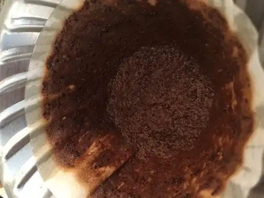

Here the 3 or 4 to 1 weight ratio, of water to beans for the stir ensures great effect: add water and go for 10-15 secs - the grounds all settle down again. Indeed, Rao will stir again or "excavate" as he calls it - after the pour is complete. and then swirl as well to get a nice flat even finish on the bed (example shown below from one of my pours).
But as we say in our lab : test it yourself - it's funner that way - and if you haven't - how do you know?3
You can also check your work post pour to see how much water has been absobed from your pour. Double the amount of beans or better, pretty good.
m.c. image of nice flat bed - using the stir the slurry approach [nice flat bed - using the stir the slurry approach]
