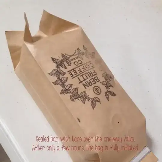

This is why it's predominantly used in food packaging and not just for coffee packages, the foil is essentially a barrier to the outside environment to stop the beans from being exposed to oxygen and light, although some carbon dioxide gas will build up, there is a relief/degassing valve to allow this to escape
