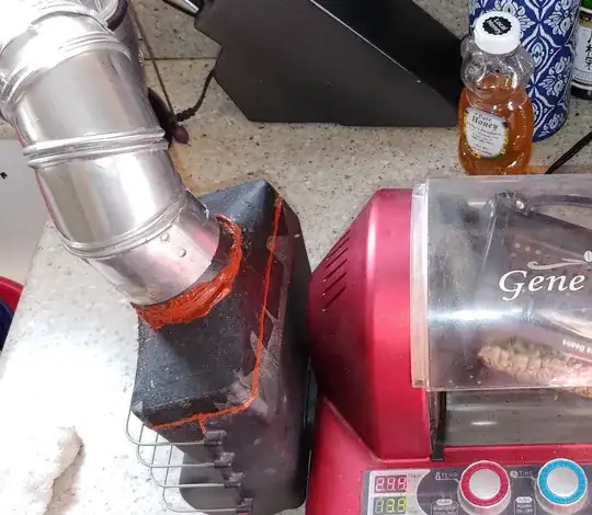

I have been home roasting with a Gene Cafe since early this last summer. I chose the Gene Cafe specifically because it appeared to be designed for attachment to a permanent vent solution. However, I've since found that the three inch exhaust is a very rough fit and that the chaff collector leaks smoke as well. The vent hole I have installed in my house is also less than optimal since it tends to leak cold air in quite a bit even with two stops installed. Does anyone have a setup in place that has very little (or better yet, no) smoke leakage when roasting? What are the elements you have involved to create your smoke free roasting apparatus?

I finally noticed that the chaff collection unit is actually several pieces that don't fit as well as they could. I took it apart and sealed the seams with high temperature engine gasket sealant. I then used the sealant to connect the vent hose to the top of the chaff collector (also a very rough fit).
I still have some problems with cold air inflow on the vent through the house wall, but I can disconnect the vent hose from the house vent and stuff it with rags or other temporary insulation material if I choose.
All said and done the machine is leaking far less than half the smoke it was previously. It seems the chaff collector was a main part of the problem. This makes sense as the exhaust there is making a 90 degree turn, expanding into a chamber, then compressing back into another pathway.
UPDATE: enter image description here
Complete misunderstanding of the problem. The exhaust vent is sized down and WILL connect and properly seal on a piece of exhaust pipe fitting. I am not sure why the company sized it this way, but sealing the seams and using a piece of exhaust joint (rather than slipping the vent hose/pipe over the exhaust) works like it was probably designed to.
