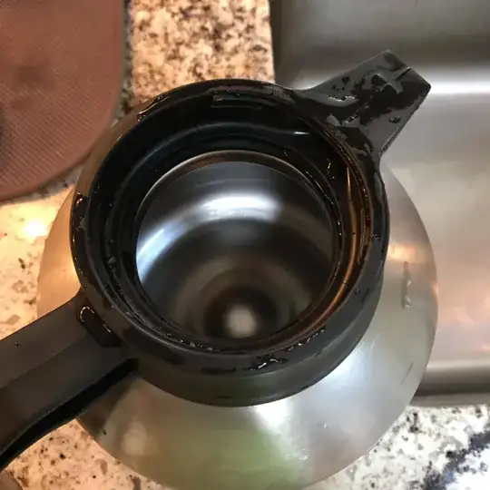

I have finally found the quick & EASY way to clean my stainless steel coffee carafe. I am just amazed! It worked like magic. Just put a Cascade dishwasher detergent pod inside of your carafe. Boil water on the stove and then put your carafe in the sink and fill it to the top with the boiling water. It only takes about 30 minutes. I did this, walked my dogs, came back and by the time I got back the water in the pot was black. I used a long-handled spoon to stir it (know anyone who can fit their hands in one of these?!), poured the BLACK water out and it was spotless. I don't mean pretty clean. I don't mean very clean. I mean SPOTLESS. I don't think my stirring with the spoon made one little difference. I think Cascade and boiling water did that all on it's own. So happy!enter image description here
