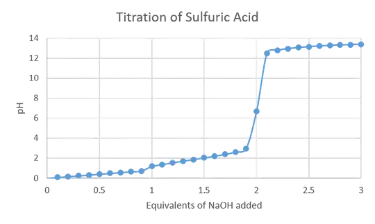

What evidence do we have for this step-wise ionization? We have titrations! If we add small volumes of a solution of a stong base (say $\ce{NaOH}$) of known concentration to a solution of sulfuric acid and monitor the pH, we can see two distinct equivalence points (the inflection points on the graph where the pH change is very large over a small volume of base added) corresponding to the two ionization events. However, because the first ionization of sulfuric acid is complete before the base is added, a titration curve of sulfuric acid will only show one equivalence point when two equivalents of base are added (though there is a blip at 1 equivalent).
graph of tritration curve of sulfuric acid showing pH as a function of equivalents of NaOH added

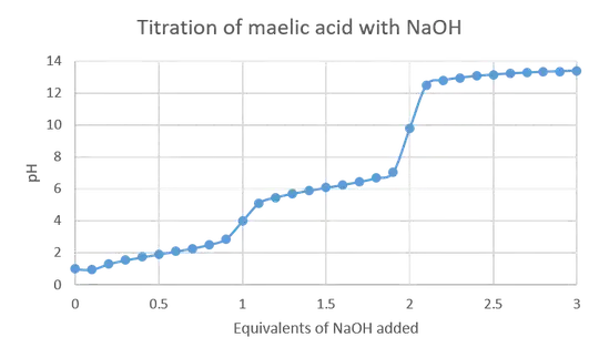

If we consider maleic acid $(\ce{H2C4H2O4})$, for which both ionizations are "weak" $(K_1=1.26\times 10^{-2},\ K_2=8.51\times 10^{-7})$, we get a different looking titration curve with inflections at 1 and 2 equivalents of base. If the ionization of both protons occurred simultaneously, we would not see a curve like this.
$$\ce{H2C4H2O4 +H2O <=> HC4H2O4- + H3O+}\\ \ce{HC4H2O4- + H2O <=> C4H2O4^2- + H3O+}$$
graph of tritration curve of maelic acid showing pH as a function of equivalents of NaOH added

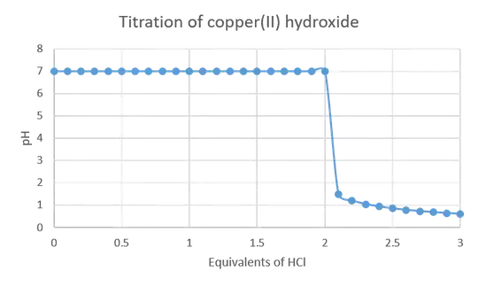

Bases that are the hydroxide salts of metals are ionic compounds. Though many of them have poor solubility in water, what is dissolved is completely ionized. Thus, for copper (II) hydroxide in water at equilibrium, there is only solid copper (II) hydroxide ad solubilized copper(II) and hydroxide ions:
$$\ce{Cu(OH)2 (S) <=> Cu^2+ (aq) + 2OH- (aq)}$$
A titration curve for copper (II) hydroxide with a strong acid like hydrochloric acid would show only one equivalence point at two equivalents of acid:
graph of a titration curve for copper(II) hydroxide showing pH as a function of equivalents of acid added
All ionic bases will behave similarly.
