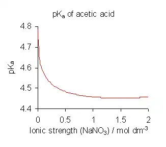

In reality, $K_\mathrm{a}$, when defined as a product of concentrations, is not a constant:
https://commons.wikimedia.org/wiki/File:PK_acetic_acid.png
Upon dilution (decrease in ionic strength) the $\mathrm{p}K_\mathrm{a}$ will change, and therefore the pH of the solution will change.
