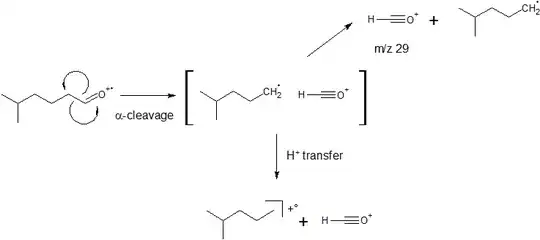

Although satisfying for the initial question, this does not address the case of the branched aliphatic aldehydes, for which no hydride transfer can lead to the formation of a carbonyl group before cleaving the carbonyl - carbon bond. Considering that the final product is in this case an ionized alcane, the mechanism for the rearrangement cannot proceed through a final bond cleavage which would lead to a bond deficient (unsaturated) system. Somehow, the system has to go through a partially bonded state at one stage. The following proposal could work out:
Scheme for CO loss - second hypothesis
Initially, the system proceeds though standard α bond cleavage which would usually lead to formation of the m/z 29 $\ce{HCO^{+}}$ ion (present in small abundance in the original question as well as in most aldehyde spectra). An ion-neutral intermediate complex is formed in some instances (although eventually the two steps might be not absolutely separated), which can lead to a proton transfer between the $\ce{HCO^{+}}$ ion and the alkyl radical. This transfer is thermochemically favorable and would lead to loss of $\ce{CO}$.

  1. The thermochemistry for final proton transfer is favorable. Not many radicals have thermochemical data, but one takes the propyl radical (Enthalpy of formation for the propyl radical 100 kJ/mol; Ionization energy of propane 10.94 eV; Enthalpy of formation for propane -104.7 kJ/mol; Enthalpy of formation for $\ce{H^{+}}$ 1530 kJ/mole) one can evaluate its proton affinity at 680 kJ/mol. In comparison, proton affinity of $\ce{CO}$ (at C) is of 594 kJ/mol, thus the proton transfer is exothermic by more than 80 kJ/mol. For ketones, α-cleavages lead to the formation of $\ce{RCO^{+}}$ ions, with R an alkyl group, which cannot as easily transfer a proton (proton affinity of the neutral ketenes on the order of 825 kJ/mol) which also explains why similar rearrangements would be specific of aldehydes.
  2. Fragmentation of the ionized alcane should occur and be present in the mass spectrum. Indeed, as shown in the figure below, some ions (notably m/z 71, 43 and 27) are present in the fragmentation of ionized 2-methylpentane and also in that of 5-methylhexanal, and can harldy be explained by α-cleavage of the aldehyde or by a McLafferty rearrangement alone. Nevertheless, this is a rather weak point: loss of water is also typical of aldehyde and leads to ions which could further fragment into these ions also.
A concern with this hypothesis is that a proton transfer to a radical is not a well established process. Indeed, formation of an ionized alcane leads to an ion which cannot be directly represented using standard Lewis notation, which makes writing mechanisms involving this species a bit worrisome.
The second problem is that although ion-induced dipole interactions are not negligible, the binding between $\ce{HCO^{+}}$ and the alkyl radical is likely to be weak compared to other ion neutral complexes. Thus its lifetime might be too short to allow a proton transfer step.
Further work on this subject should, in my opinion, try to focus on, (i) experimental validation of the loss of CO, and ideally, using D-labelled compounds validate the hydrogen transfer hypothesis. MS/MS fragmentation of the M-28 ion would also allow validation that an ionized alcane is indeed formed in the process. Finally, the mechanism should be validated through some theoretical calculations, at least for the formation of an ion neutral complex and for the barrier (and ideally RRKM kinetics) for the proton transfer within the ion neutral complex.
