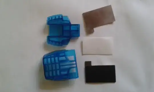

I'm a bit confused. I've got this "toy" ... with the help of this site I was abled to find out that the reaction stops with a lack of air. Link to the old question.
The battery/fuel cell or however you call it consists out of following components:
  • magnesium plate
  • isolator which consists out of something like paper, the surface feels more like cotton
  • the black plate is called "black cathode" in the manual, my hypothesis is that it might be rubbered graphite or a polymer, because it has a very low electrical resistance.
  • the electrolyte is a $\ce{NaCl}$ dispension- I think it just need to lower $\ce{H2O}$'s electrical resistance
  • plastic stuff is only the case of the "cell" enter image description here

What you have is classified as a Mg-air battery. You can read more about it here : https://en.wikipedia.org/wiki/Category:Metal-air_batteries
These are a class of primary(i.e. not rechargeable) batteries, where the anodic reaction is a metal being oxidised and the cathodic reaction is oxygen reduction.
The reactions are:
$\ce{Mg → Mg^{2+} + 2 e^{-}}$ on the anode
$\ce{O2 + 4 e^{-} + 4 H+ → 2 H2O }$ on the cathode, if the reduction goes to completion. Most of the time, it is only reduced to the peroxide or the superoxide which is considered incomplete reduction.
For it to be classified as a fuel cell, the fuel for the anodic reaction would need be brought from the outside(source: anectodal, personal thought).
Burak Ulgut
  • 1,743
It is a fuel cell because the magnesium anode is consumed by the oxidation reaction and is then replaced by a new anode. This example being a toy is a very simplified version where the full scale fuelcell has a continuous roll of magnesium foil, once the surface is oxidized the roll slowly advances until it is entirely expended and then replaced to start again. If the container were not excess able for cartridge replacement it would be disposable and would be considered a primary cell.
user30934
I would say more : $$\ce{O2 + 2H2O + 4e- → 4OH-}$$ $$\ce{2Mg + 3OH- → 2 Mg2+ + 4e-}$$ (2.93V global potential so 6,46 kWh/kg theoritical energy density)
It is a potential fuel cell by adding magnesium pellets continuously with oxygen from the air.
