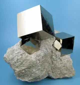

Pyrite ($\ce{FeS2}$) forms cubic crystals, like these ones:
I know that the crystal structure is primitive cubic, but I don’t see how cubic structure on the molecular level translates to cubic structure on much larger scales. If you are given some number of cubes, there are many different ways to assemble the cubes face to face, and only one of these ways is to create a large cube. So why is it that the pyrite in this rock forms nearly perfect cubes?

Coincidence.
While pyrite crystallises in spacegroup $\mathrm{Pa\bar{3}}$, i.e., a cubic spacegroup, there is no guarantee that the unit cell shape is resembled in the macroscopic crystal shape. The faces of the crystal do however always represent a plane that can be described by some Miller indices of the crystal lattice. And indeed, there are multiple alternative crystal habits for pyrite (eg dodecahedral, see Wikipedia article and santiago's answer), while retaining the same internal structure. Which habit forms in practice, is mainly determined by the crystallisation conditions. These have to be determined empirically, as there is no way to predict them.

    It's not coincidence obviosly because the probability that you arrange say a million cubes face-to-face and end up with a perfect cubes is basically 0. Still no one has managed to answer my question. – math_lover May 22 '15 at 21:25
  • There is exactly one way to arrange the unit cells ("cubes") - otherwise you would not have a crystal. This makes the internal symmetry. What I am saying is, is that this single internal structure can lead to to multiple appearances of the macroscopic crystal - and that there is no way of accurately predicting what that would look like ("coincidence"), even though it puts some limits to it. – Gerhard Jun 04 '15 at 07:25

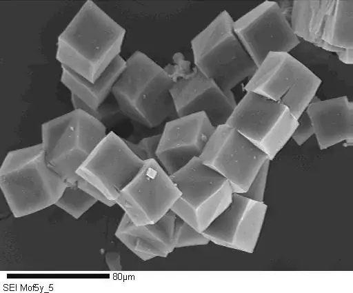

To enhance the point -- even more complex but still cubic unit-cell materials make macro-cubes, if pure of foreign material, e.g. MOF-5 and others:
