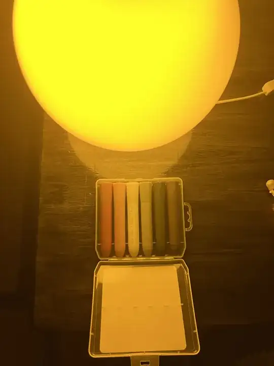

I have some green, blue, and purple markers which clearly fluoresce under monochromatic light with a lower wavelength. Here they are illuminated by 589nm light emitted by a low pressure-sodium lamp (SOX light):
markers under sox lamp

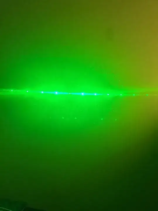

And here lit by the diffuse light from a a 532nm +/- 10 green laser: enter image description here

By my understanding, that means it shouldn't be possible for either the blue or purple marker to be fluorescing under either light source because blue and purple light has a shorter wavelength.
What is happening?

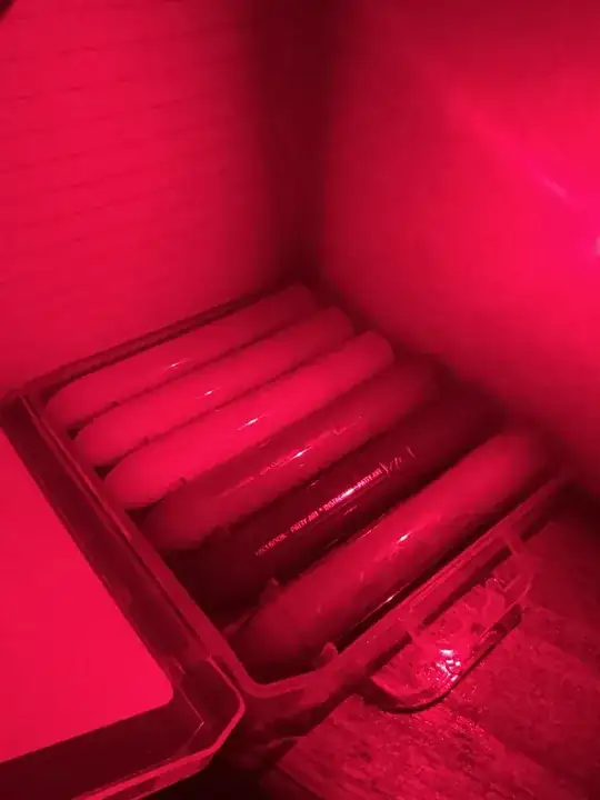

Markers lit by 650nm +/- 10 red laser light. The blue marker looks like it might be slightly blue to my eye, but it's hard to say. enter image description here

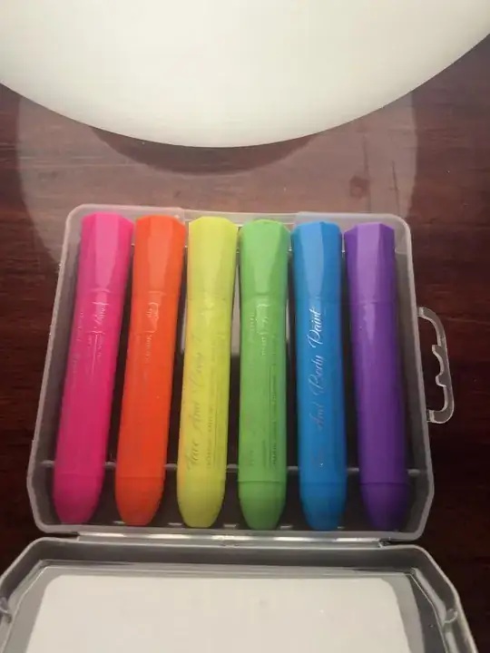

Markers lit by sunlight: Markers under sunlight
Markers lit by incandescent light:

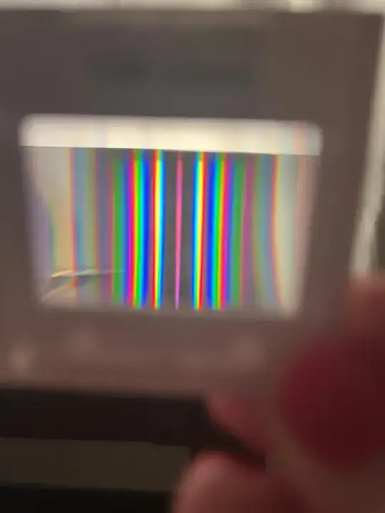

Viewing the SOX lamp through diffraction grating with 100 lines/mm:
In contrast to an incandescent light viewed through the same grating:

The green laser shined at the wall through the diffraction grating:

This is an interesting observation and one can appreciate that the OP thought about two photon absorption as a. A couple of observations first that challenge the hypothesis. Ordinary sodium lamps or even street sodium lamps are not monochromatic at all. If you have diffraction grating, view this lamp via narrow cardboard slit and you will see an entire line spectrum which is very beautiful. The Na-D 589 nm line is intense but other shorter wavelengths are present too. This is why you can see the markers, but they are not fluorescing at all in my opinion. If it were pure 589 nm, the markers would be appearing black just like the two on the right. You can test the fluorescence rather in solution with a yellow highlight. Dip the tip in water and view it in sunlight and in this low pressure lamp. You will see the difference.

  • I added a picture of the light from the low-pressure sodium lamp to the original post. I also added photos of the markers lit by monochromatic laser light. – Henry Marshall Jan 25 '24 at 17:07
  • @HenryMarshall, Nice work and hopefully now you see that was not fluorescence or two photon fluorescence. – AChem Jan 27 '24 at 15:43
  • Thanks. I am even more confused now. The crisp lines from the diffraction grating has me convinced that both the SOX lamp and green laser are in fact monochromatic. Does this seem true to you? If the light is monochromatic, how is it possible that the markers are showing blue and purple? – Henry Marshall Jan 28 '24 at 10:44
  • @HenryMarshall, The SOX is not monochromatic. It has green to green. Otherwise the markers would be invisible (black). – AChem Jan 28 '24 at 16:02
