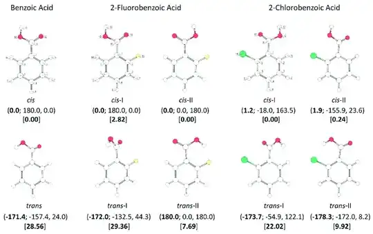

Regarding the conformers of the 2-FluoroBenzoic Acid
A throughout conformational search on the B3LYP/6-311++G(d,p) potential energy surfaces of the studied molecules (the mono- and di- ortho fluoro- or/and chloro- substituted benzoic acids, plus the parent benzoic acid, for completeness) was undertaken. The identified conformers are presented$^{[2]}$enter image description here
Here both the cis conformers are planar and low energy while only one trans conformer is planar while both of them are relatively high energy of which Trans II is of relatively lower energy.
The two cis conformers have rather similar energies, with cis-II (where the fluoro-substituent stays the same side of the molecule as the acid oxygen atom and a C-H . . . O= stabilizing interaction exists), being the most stable form. The cis-I conformer has a relative energy of 2.82 kJ·mol−1 . In this conformer, the C-H . . . O= interaction present in cis-II is replaced by a weaker stabilizing C-H . . . OH interaction. The C-H . . . O= interaction is more efficient in stabilizing cis-II than the C-H . . . OH interaction in stabilizing cis-I due to the more favorable localization of the interacting carbonyl oxygen lone electron pair, which stays in the molecular plane, whereas in cis-I both lone electron pairs of the acid oxygen atom are out of the molecular plane. On the other hand, the interactions between the fluoro-substituent and the oxygen atoms, which are of repulsive nature, also favor a lower energy for cis-II compared to cis-I. This can be rationalized in similar terms as for the interactions involving the ortho hydrogen atom discussed above. In cis-I, the F . . . O= repulsion is stronger than the F . . . OH repulsion in cis-II because the interacting lone electron pair of the carbonyl oxygen atom is in the same plane as the fluorine atom in the former conformer, while the lone electron pairs of the acid oxygen atom in cis-II are both out of the plane in relation to the fluoro-substituent.$^{[2]}$
It is important to note that though the population level of Trans II are low, it is still a stable compound and nevertheless has been detected.$^{[3]}$

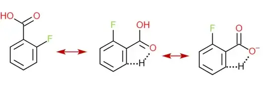

So.. Why is 2-fluorobenzoic acid more acidic than 4-fluorobenzoic acid?
I could not find any research for this but I could make an educated guess that the acidity of 2-fluorobenzoic acid comes from the similar stabilization as that in salicylic acid.$^{[4]}$ in the conformer cis II as shown below:-
