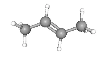

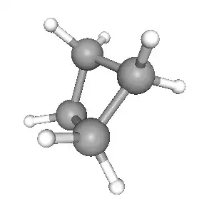

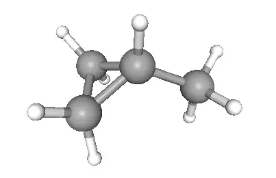

You can look at C/H ratio and easily tell a bit here. There must be at least one of the following, but not two:
- carbon ring
- carbon double Bond
(2) 2-Butene which has two stereoisomers

1Specifically, calculating the degree of unsaturation of the compound will tell you that either one ring or double bond exists. – Box Box Box Box Feb 28 '21 at 13:03
